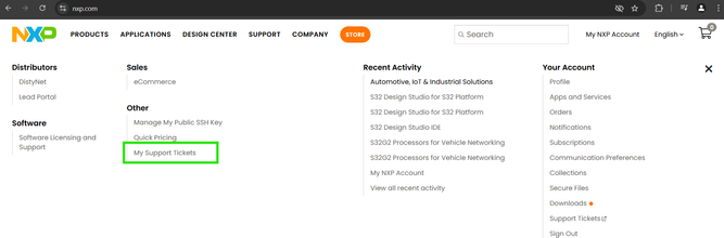

If you don't want to share sensitive information using this public community, you can open a support ticket using the nxp page: 
