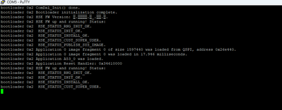

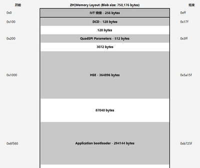

Quincy_Wen
Because the time interval is too long, I can't remember the details.
But luckily I found the blob image, as shown in the screenshot, you can refer to it

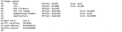

The following is my image layout after enabling hse on a core :
The following shows my blob:

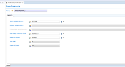

The following is the Eb configurations :

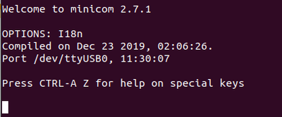

    The output is stuck and does not transition to u-boot as shows :
    Could you please let me know the issue?

Quincy_Wen
Perhaps there is an issue with your EB configuration. For example, the value of the source address (QSPI) at 0x264ee0 should be changed to 0x200000. Additionally, you need to pay attention to the requirement of 1KB alignment, although it might also be 4KB alignment (different flashes have different alignment requirements).

ashwini2024
Hello @Quincy_Wen
Thank you for the reply.
1)I changed the source address to 0x200000 but i am observing the same, control does not go to u-boot
2)Could you please elaborate more on the alignment, were u referring to A core alignment or was it on the bootloader side ?
