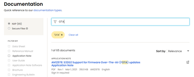

More information on regards of OTA can be found under the S32G2 product page (link: S32G2 Safe and Secure Vehicle Network Processor | NXP Semiconductors) within the AN12978:
