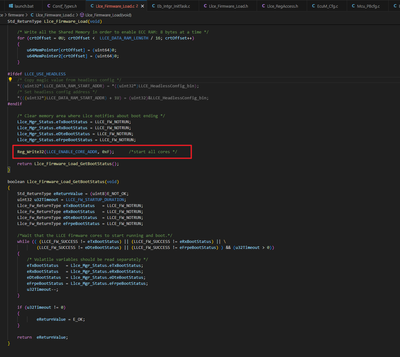

after this step,the firmware can not startup and the status of the firmware keep in "notrun",is there anyone who have meet this problem?please help me.

Hello, @LeeBai
Thanks for the feedback.
As indicated in the GoldVIP UM, the software prerequisites for LLCE is 1.0.7, you may have a try with this version instead of 1.0.4.
Besides, the GoldVIP you used is only tested under S32G Reference Design Board 2 (RDB2) and S32G GoldBox, there may be issues found on different designs.

Hello, @LeeBai
Thanks for the question.
May I know if you may help to clarify the following information:
Which version of LLCE firmware used? Which sample? It is running on a S32G2RDB2 or custom board?
Would you please provide detailed steps of triggering the error?
Best Regards
Chenyin

hi,thanks for your reply.
here are some details about the problem:
1.the version of LLCE is 1.0.4;
2.the sample is a project named "simple_demo_can_rte" provided in the GoldVIP package(s32g2,1.11.0);
3.it is running on custom board;
4.first i added a CAN LLCE module in the project,changed the clock of the MCU, then added the
Llce_Firmware_Load function in the EcuM_Init to download the firmware,compiled the program and run in the target board,at last i triggered the error
