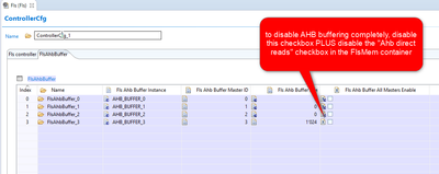

Hi all,
am working on an S32G274A board (bt not one of the NXP products, it is manufactured by a 3rd party), it has a Micron
MT35XU512ABA octal serial NOR flash mounted. for the M7_0, I have to adapt the RTD/MCAL fls configuration LUT sequences, until now with mediocre success.
(current RTD version: SW32G_RTD_4.4_3.0.2_HF01)
Reading and writing the special configuration registers in STRD mode (when booting) seems to work. Then I switch to octal DDR mode, but either my write or my read sequences
fail to work correctly. No errors reported, but I can not confirm by reading back what I have just written to the flash memory.
it is not an issue wth the write enable, the RDT drivers set this automatically.
to rule out that it has something to do with the AHB buffer, I would like to disable the AHB feature (the S32G2 reference manual sugessts that there is the option between
- IP command read (I would like to try that)
- AHB read (used in all examples from NXP)
I was wondering how to disable or remove the AHB feature from my configuration (in Tresos). But removing the subcontaines in the AHB configuration yields a tool error.
--> How do I get to use a bare IP command read ?
And follow up question: are there examples with Micron flash configurations available (for the M7) ?
thanks and best regards,
Stefan

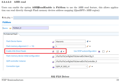

Daniel-Aguirre
The User Manual for the FLS driver provides information on regards of the AHB usage under a read command. The following snip is provided from the User Manual:
AHB can only be used under a read command, for which any write commands should not be valid through AHB. Also, the following limitation is shown under the User Manual:
"Users must add and use MPU to configure the QSPI AHB address space as device memory to prevent speculative reads in this region"
Please, let us know.

SSyb
Hi @Daniel-Aguirre ,
Thank you for the hint, the checkbox in the FlsMem container I had missed (I was focused on the Fls ConrollerCfg->FlsAhbBuffer container).
To switch the AHB buffering off completely, I noticed that also the "Fls Ahb Buffer ALl Masters enable" checkbox must be disabled in the ControllerCfg contrainer (plus the one that you mentioned), then it works.
Thx again,
best regards,
Stefan
