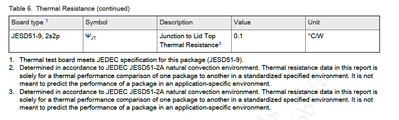

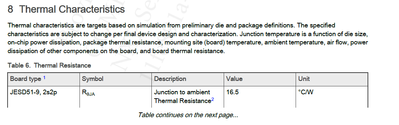

In our S32G2 data sheet we provide:
and
What they are looking for is θ_jc ( which is the Thermal Resistance Junction-to-Case ) rather than the Ψ_jt ( which is Junction-to-Top (of Package) Characterization Parameter ) that is the second row of Table 6 of your referenced datasheet.
Where can I find the θ_jc ( which is the Thermal Resistance Junction-to-Case )?

Junction to Ambient Thermal Resistance1
JESD51-9, 2s2p
RθJA
16.5
°C/W
Junction-to-Top of Package Thermal Characterization Parameter1
JESD51-9, 2s2p
YJT
0.1
°C/W
Junction to Case Thermal Resistance3
N/A
RθJC
0.65
°C/W
Foot Note:
  1. Determined in accordance with JEDEC JESD51-2A natural convection environment. Thermal resistance data in this report is solely for a thermal performance comparison of one package to another in a standardized specified environment. It is not meant to predict the performance of a package in an application-specific environment
  1. Thermal test board meets JEDEC specification for this package (JESD51-9).
  2. Junction-to-Case thermal resistance determined using an isothermal cold plate. Case temperature refers to the lid surface temperature.
