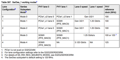

Q1 >> If SerDes_1 lan0 and lan1 working in SGMII mode, it needs to work with PFE_MAC0 and PFE_MAC1?
A1 >> For SerDes_1, your assumption is correct. You should be setting SerDes_1 to Mode 3 for both Lan0/1 to be configured as SGMII, for which PFE_MAC0 and PFE_MAC1 will be available. Table 397 [Page 2445, S32G2 Reference Manual, Rev. 6, 11/2022] provides this information:

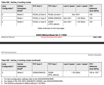

Daniel-Aguirre
SerDes under SGMII configuration without PFE is only available under SerDes_0 Mode 1 or 3, which mode 1 uses PCIe on Lan 0 and GMAC0 on Lan1 and mode 3 uses GMAC0 under Lan0 and PFE_MAC2 under Lan1. Table below:

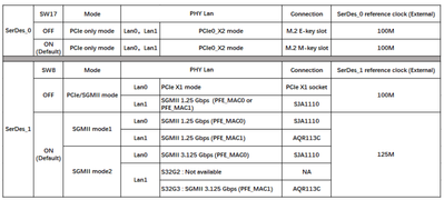

Since you are working with the RDB2 platform, SerDes_0 is not available for this configuration modes. This is shown on the table provided on Sheet 16 of the schematic for RDB2:
