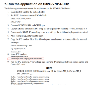

I strictly follow "AN13750" for operation, and the software versions are also the same. When executing to the position shown in the figure below, an error occurred:
s32g274ardb2 login: root
root@s32g274ardb2:~#
root@s32g274ardb2:~# ls
root@s32g274ardb2:~# mkdir ipc
root@s32g274ardb2:~# mount /dev/mmcblk0p1 ./ipc
root@s32g274ardb2:~# cp ./ipc/ipc-shm-* ~
root@s32g274ardb2:~# umount ./ipc
ipc ipc-shm-dev.ko ipc-shm-sample_multi-instance.ko
root@s32g274ardb2:~# insmod ipc-shm-dev.ko
root@s32g274ardb2:~# insmod ipc-shm-sample_multi-instance.ko

I am referring to IPCF kernel panic - NXP Community  Disable DCach and Clear SRAM. There will be no kernel crashes, but new issues will arise:
root@s32g274ardb2:~# echo 1 > /sys/kernel/ipc-shm-sample-instance1/ping
root@s32g274ardb2:~# dmesg | grep ipc-shm-sample_multi-instance
[ 63.397060] ipc-shm-sample_multi-instance: starting demo on instance 0...
[ 63.397085] ipc-shm-sample_multi-instance: INST0 ch 0 >> 19 bytes: SENDING MESSAGES: 1
[ 63.397098] ipc-shm-sample_multi-instance: send_data_msg(): failed to get buffer on instance 0 for channel ID 1 and size 32
[ 422.873017] ipc-shm-sample_multi-instance: starting demo on instance 1...

Have you replaced the kernel Image yet? This situation may occur if the kernel for compiling IPCF is different from the Kernel version used.
