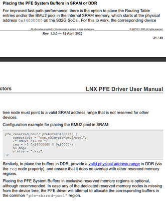

By default, when integrating the PFE driver into the `fsl-image-auto`, `s32g-pfe-bmu2-pool` and `s32g-pfe-rt-pool` are placed in SRAM.
I need to move them to DDR, but I have tried various configurations, and I cannot get the driver to work.
I cannot find the requirements for placing the buffers in DDR.
Could you please suggest a possible configuration?
Thank you.

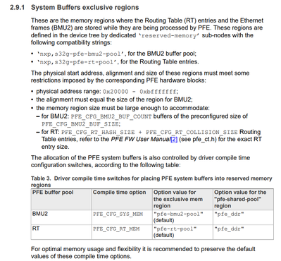

Daniel-Aguirre
Can you confirm which PFE-FW version you are working with? We also see the following information is provided under the LNX PFE Driver User Manual:
Also, the following requirements are provided:
Please, let us know.
2,076 次查看
agarcia2945
Thank you for your response.
We are currently using the `NXP S32G PFE Firmware version 1.8.0`.
Also, I'm seeking clarification regarding the requirement stating "the alignment must equal the size of the region for BMU2." Could you please elaborate on this requirement and provide examples to better understand its implementation?
Thank you.

Thanks for your feedback. We understand that the following information is available:
Moved bmu2 to address 0x83600000 successfully. Actually only device tree should be modified.
1. chage device tree s32g.dtsi.
pfe_reserved_bmu2: pfebufs@83600000 {
compatible = "nxp,s32g-pfe-bmu2-pool";
/* BMU2: 512 KB */
reg = <0 0x83600000 0 0x80000>;
no-map;
status = "okay";
pfe_reserved_rt: pfebufs@83680000 {
compatible = "nxp,s32g-pfe-rt-pool";
/* RT: 128 KB */
reg = <0 0x83680000 0 0x20000>;
no-map;
status = "okay";
2. recompile linux kernal and sdcard image
We can see the following lines.
[ 8.835356] pfeng 46000000.pfe: assigned reserved memory node pfebufs@83600000
[ 8.835410] pfeng 46000000.pfe: assigned reserved memory node pfebufs@83680000
[ 8.864505] pfeng 46000000.pfe: BMU2 buffer base: p0x83600000 (0x80000 bytes)
