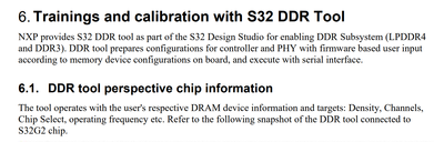

563 Views
Joey_z
hi,arun_belamge
Sorry for that we do not have the direct guide for S32G3.
You also can try to refer to s32g2 reference to create DDR code for using S32G3.
Also, you can refer to the AN12848 to find more DDR information. About how to use the DDR Tool.
AN12848: DDR Initialization and calibration on the S32G2 Vehicle Network Processor Application Note
Hope this can help you.
Joey

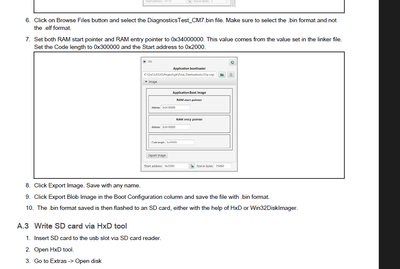

413 Views
arun_belamge
Hi Joey.
I followed the document, S32G-VNP-EVBx Diagnostics (Document identifier: S32GVNPEVBXDGUG).
Using this, I created the blob.bin as follows:
Set both RAM start pointer and RAM entry pointer to 0x34000000. This value comes from the value set in the linker file.
Set the Code length to 0x300000 and the Start address to 0x2000.
And, No I do not have any debugger currently at my disposal.
Thanks.
Arun

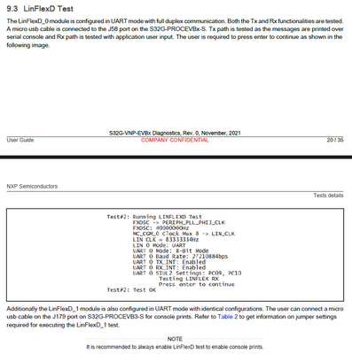

arun_belamge
Hi Joey.
The UART demo also seems to not work on the G2 board.
I suspect, its the default Linflexd_UART_1 channel which is not present on the S32G-PROCEVB-S processor board ONLY. I do not have the evaluation board.
Please clarify, the UART present on the board is J58 and not J1 which is given in the example project.
If thats the case, how do I initialize the UART0, J58 and print on the console?
Thanks.

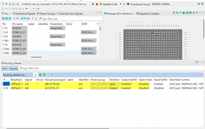

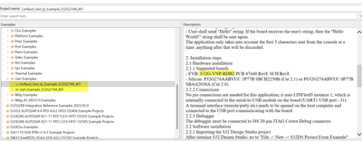

368 Views
Joey_z
hi,arun_belamge
Thank you for your reply.
The demo of Linflexd_Uart_Ip_Example_S32G274A_M7 uses the RDB2 board.
And it uses the J1 for UART1 as the following picture.
Joey

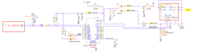

arun_belamge
Hi Joey.
Thanks for pointing it out.
But, in the diagnostic test project, LinflexD_UART_0 i.e., J58 is being used to print on the console.
So, it should have worked...
Is the Baud rate:9600 or 27210884bps as given in the diagram?

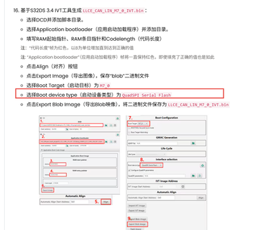

190 Views
Joey_z
hi,arun_belamge
The diagnostic of your showing if for EVB board, and the RTD demo is for RBD board, so it has the different hardware setting.
Yes, you can try to flash the app to QSPI flash instead of SD card. You can try to refer to this link:
Getting Started with the S32G Reference Design Board 2 for Vehicle Network Processing | NXP Semicond...
Getting Started with the S32G Evaluation Board for Vehicle Network Processing | NXP Semiconductors
