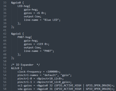

We don't seem to reproduce the behavior you are seeing. Instead of the code you did under "fdts/s32gxxxa-rdb.dtsi", we just add the following:
&pfe {
	status = "okay";
+&gpio {
+	LED-hog{
+		gpio-hog;
+		gpios = <119 0>;
+		output-low;
+		line-name = "PA_06_LED";
/* IO Expander  */
&i2c0 {
Since PH_07 (GPIO 119) under RDB2 is configured to work under the PFE2 interface, we do not have anything humanly visible to confirm the change. Still, we did use the same code with the difference of selecting "gpios=<6 0>" and we did see the LED turn ON (as seen under the "line-name" property).
On both configurations, we could log into Linux no problem.
Please, let us know.

We cannot replicate the exact issue you are seeing on your setup.
We have configured both PA06 and PH07 on our board under BSP33.0 as follows:
arm-trusted-firmware\fdts\s32gxxxa-rdb.dtsi
When we see the status under u-boot, we have the following:
What we are seeing is that you are setting PH07 under SIUL2_0, which is incorrect, since PH07 corresponds to SIUL2_1. As for the number, it is the assigned logical number, but referring to PH07 as 119 should be the correct way.

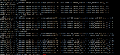

We may not understand the comment "found that the <pinctrl_offset> value returned by s32cc_get_pinctrl_offset() is the same (=119).". For both PJ07 and PH07 it returns the same value?
How and when are you calling the function?
9,035 Views
petertseng
Hi Daniel,
If you debug both PH07 and PJ07 in s32gxxxa-rdb.dtsi, you will get probe error message.
But debugging one of the GPIOs alone and tracking the <pinctrl_offset> value returned by s32cc_get_pinctrl_offset() in s32cc_gpio_direction_output() will get the same result (=119)
u-boot_2020.4/drivers/gpio/gpio-s32cc.c
@@ -124,6 +129,7 @@ static int s32cc_gpio_direction_output(struct udevice *dev, unsigned int offset,
        int ret;
        ret = s32cc_get_pinctrl_offset(priv, offset, &pinctrl_offset);
+       printf(":%s: offset=%d, pinctrl=%d (ret=%d)\n", __func__, offset, pinctrl_offset, ret);
        if (ret)
                return ret;
I think the reason for the probe error is that the last <desc->offset> values generated by the two GPIOs when calling s32cc_gpio_get_xlate() are the same as 7.
PJ07:  desc->offset = 151 - 144 = 7
PH07: desc->offset = 119 - 112 = 7
Peter
9,011 Views
Daniel-Aguirre
Thanks for your feedback.
It does indeed seem to be a bug under the driver. We could replicate the issue you were seeing.
It does seems that since PH07 and PJ07 have the same offset (but on different ranges) the PJ07 (gpio 151) hog was being put under the PH07 address (gpio 119), shown below:
Where PJ07 should be under "siul2-gpio118", instead of "siul2-gpio17".
By applying the patch under the xlate function that you have provided we can see both PH07 and PJ07 under the correct address, as shown below:

I also tried to define the PH07 pin using gpio-hog
u-boot_2020.4/configs/s32g274ardb2_defconfig
--- a/configs/s32g274ardb2_defconfig
+++ b/configs/s32g274ardb2_defconfig
@@ -2,3 +2,4 @@ CONFIG_ARM=y
 CONFIG_ARCH_S32G2=y
 # CONFIG_SPI_FLASH_BAR is not set
 CONFIG_SD_BOOT=y
+CONFIG_GPIO_HOG=y
arm-trusted-firmware_2.5/fdts/s32gxxxa-rdb.dtsi
--- a/fdts/s32gxxxa-rdb.dtsi
+++ b/fdts/s32gxxxa-rdb.dtsi
+/* GPIO1 */
+&gpio1 {
+	pinctrl-names = "default";
+	pinctrl-0 = <&pinctrl1_gpio_hog>;
+	/* PH07 */
+	PH07 {
+		gpio-hog;
+		gpios = <119 0>;
+		output-low;
+		line-name = "PV4_EN";
+		pinctrl1_gpio_hog: pinctrl1_gpio_hog {
+			fsl,pins = <PH07_MSCR_S32G SIUL2_MSCR_GPIO>;
but get the error
