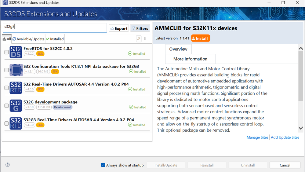

When I set up the development environment based on AN13750, I followed the steps shown in the following figure:
The following issues have occurred:
