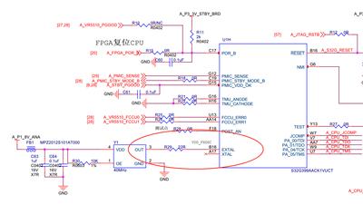

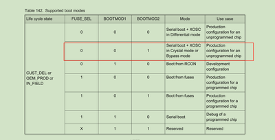

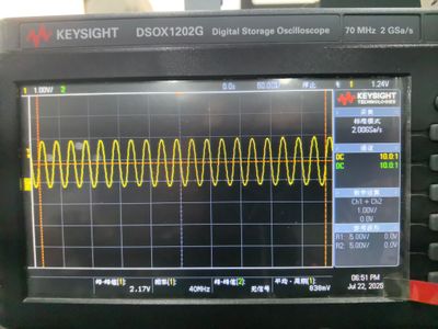

We developed a board based on the S32G3 VNP-RDB3 development board, replacing the passive crystal oscillator with an active one and configuring the BOOTMODE according to the S32DS RM.

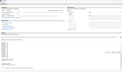

1.After programming the SRAM demo through the serial port, it can operate normally, and data can be output through the serial port. However, when programming the QSPI Flash algorithm, an error is reported, and there is no output from QSPI CS and clock.

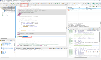

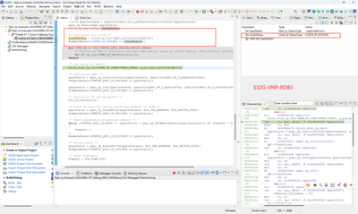

2. Using the S32DS Qspi demo, clock initialization failed.
Besides BOOTMODE, is there a need to modify the clock configuration in the code or other locations?
我们参照S32G3 VNP-RDB3 开发板做的板子,仅将开发板的无源晶振更换为有源晶振,并按照S32DS RM 配置了BOOTMODE。
1.串口烧写SRAM demo 后可正常运行,串口可输出数据,但烧写QSPI Flash 算法会报错,QSPI CS、clock 没有输出。
2.使用S32DS Qspi demo,初始化clock失败。
除了BOOTMODE,还需要在代码或者其他位置修改时钟配置吗?
