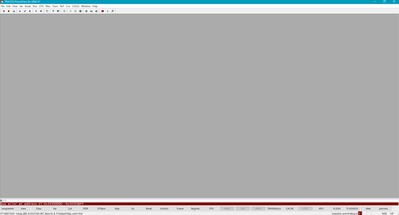

We are trying load  LwIP example on S32G-VNP-RDB2 board and the Lauterbach we use is LA-3500 (debug module) with LA-3255 and LA-7844x (debugger for ARM A/R [arm8/9] with extension to cortex M series).
But we were getting the above error (bus error at  address 0x34500000).  Is there any restriction to write to this memory location? or ho to resolve this error

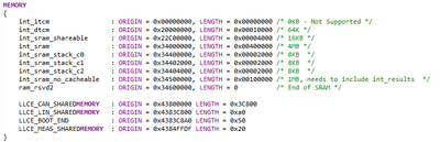

As for the memory space, we see that it is defined on the linker file, which means it should be available:

We have received the following update from our internal team:
"0x34500000 is the start address of non-cacheable memory in LwIP example, the customer used the incorrect trace script which caused this issue, the script to be used should be "s32g2_connect_m7_0". This script can found in T32\demo\arm_obsolete\hardware\s32g2\scripts"

NP1
When I open s32g2_connect_m7_0.cmm script , we were getting stopped at vector catch error . ST:3400020 [
\\User\Global\_ResetVector ]

Hi @NP1,
perfect, the core is now stopped right at it's reset vector. This is the expected result after runing this script.
