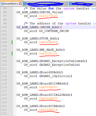

hello,
2 VMs are present in my system, on VM0 for Core0 (M7_0) and VM1 for Core1(M7_1)
Able to flash those 2 elf files on SRAM. VM0 is running fine. but  M7_1 (VM1) is not running properly.
when we check registers, the Program counter is referring only VM0 memory address.
Do i need to taken care any Register settings and boot up sequence to invoke M7_1 core.
kindly support on the same. if you need more info kindly revert.
thanks

Vijayan_Thangavel
Actually i have seen the referred document already. but in that document they are referring more on S32G tool. right now we are not implementing boot. just want to flash in the SRAM directly on M7_0 and M7_1 , and wanted to invoke the cores and make parallel run. is it possible?
latest issue: Core1 Program counter is referring Core0 program counter. seems IVT and CSR , CCR address to be set properly. could you please share snap/list of M7_1 specific registers if possible?
855 Views
Vijayan_Thangavel
as per my debugging i need to set this Registers and values I feel. could you please clarify these values for Core1( M7_1). meantime, we are not using A53 cluster right now.

Daniel-Aguirre
The specific registers for M7_1 should be provided under Chapter 32 of the reference manual [Page 1219, S32G2 Reference Manual, Rev. 6, 11/2022]. We recommend looking into Figure 152 from the Reference Manual [Page 1083, S32G2 Reference Manual, Rev. 6, 11/2022], since the flow diagram shows the different registers that are needed in order to boot an additional core.
