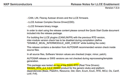

I'm developing on the S32G274 with S32DS 3.4.3
my question is for the LLCE version requirements
How do I know which version of LLCE works OK with RTD version?
is there any version description document or some versions cross reference that shows which version of any internal package is OK with the others ?
Ofer
1,455 Views
Daniel-Aguirre
Each LLCE package provides a Release Notes, in which the requirements should be mentioned. i.e. the following information is provided under the LLCE v1.0.4:
Please, let us know.

Thanks Daniel
