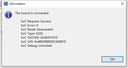

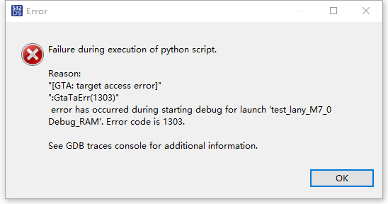

    Import RTD example Project into S32 DS V3.6.2 and compiled , connect S32 Debug probe through Ethernet. before debug, I try 'Test connection' in Debug Configuration and get the infomation back successfully. But when I try Debug,  the S32-DP can't connect to the S32G274.s32ds.png

410,319 ~"^Error:Target connection failed. Please re-check the settings."
410,319 ~"Processor: S32G2XX"
410,319 ~"Probe: S32 Debugger TAP (192.168.3.103)"
410,319 ~"[CCS: Error in part definition]"
410,319 ~"//"
410,319 ~"Additional error details:"
410,319 ~"[GTA: target access error]"
410,319 ~":GtaTaErr(1303)"

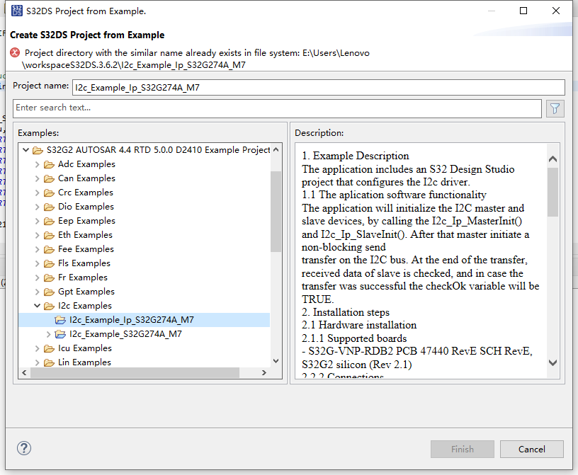

lany
Hi, Joey
Thank for your reply.
I tried the demo from S32G AUTOSAR 4.4 RTD.

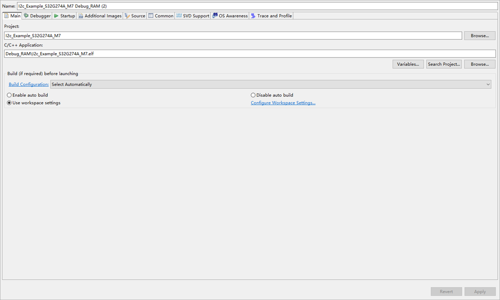

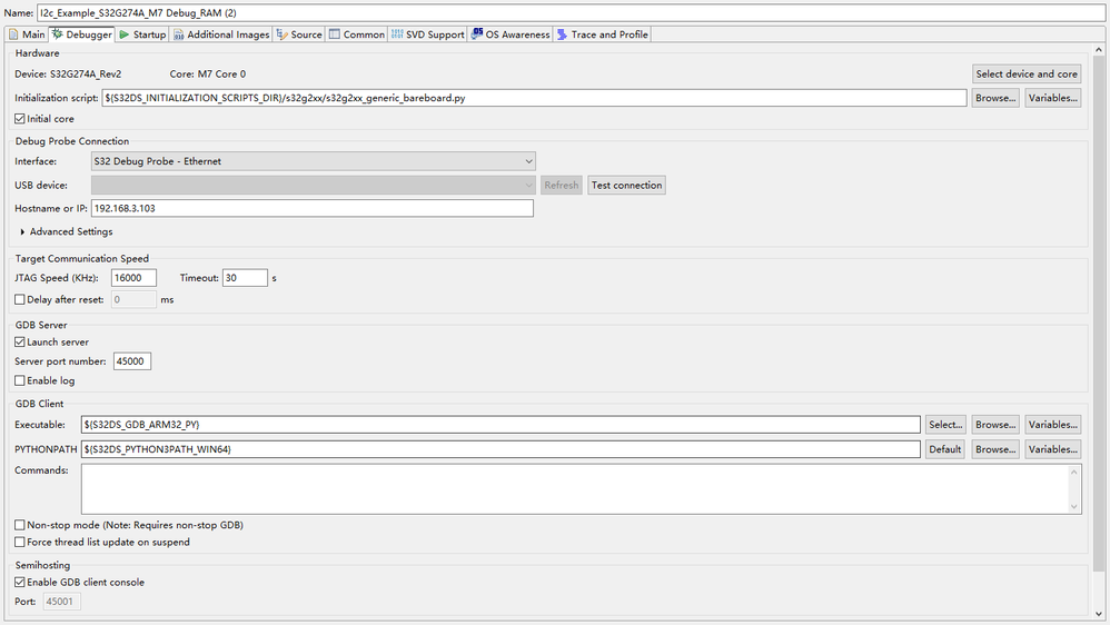

And my debugger configurature is blow.
When I try the "test connection",  the infomation back like this:

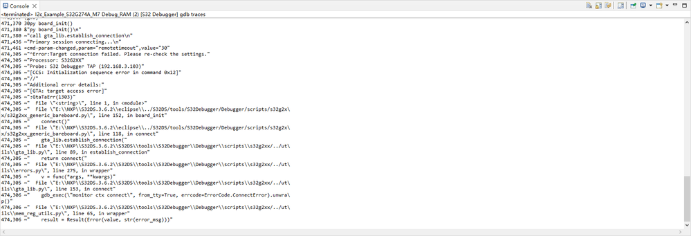

But still, the same failure came,  this is the traces infomation.SO, it confused me a lot. I get the Soc infomation successfully above, but here looks like connection failure.What should I do next?traces.png
