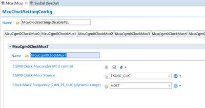

I initialized LLCE in the M0 core and configured the llce_pe clock to 40M (FXOSC_CLK) and configured the baud rate of LLCE_can to 250k, but the LLCE_can output clock that I captured through the oscilloscope is incorrect, what could be the reason?
Using clk dump in u-boot to get llce_can_pe clock as 0,as follows:

Have you configured the PLL as shown in the following picture?
If you have done, and the tf-a did not start successfully after turning on the PLL clock in McuLockSettings Disable PLL, I thank it is not suitable for you. You can try unchecking the MCU control in Mux7.

3.  I saw that the bootloader's sysdal module's powerUp ->SystemPowerUpConfiguration-0->DeinitList has the initialization of Mcu_initClock McuLockSetDisable PLL. I configured McuLockSetDisable PLL for Mcu ->McuLockSettingConfi and modified McuCGm0ClockMux7 as follows

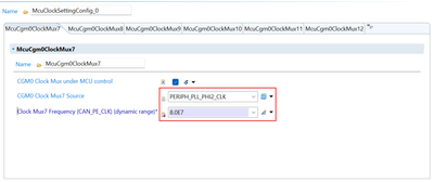

There should be an incompatibility for the llce_can_pe between the M-core and A-core, you can turn off the clock operations for llce in tf-a, u-boot, and kernel, using the values configured in bootloader.
In addition, in order to find the problem, you can try to configure CAN_PE_CLK as 40MHz in TF-A/u-boot, or set M core CAN_PE_CLK as 80Mhz as shown in the following picture.

1. I have followed your instructions and configured the CANP_PE-CLK of M7-0 core to 80M, and configured the MCU ->McuLockSettingDnfig.0 CANP_PE-CLK of bootloader to 80M, The CANP_PE-CLK in McuLockSettings Disable PLL is not configured because I found that tf-a did not start successfully after turning on the PLL clock in McuLockSettings Disable PLL;

I found through testing that I configured the clock source for McuCGm0ClockMux7 in the bootloader to be FXOSC_CLK 40M. After booting to the M0 core, LLCE.can output correctly;
If the output frequency of M0 core LLCEcan changes after the Linux startup of A core is completed, it is found through calculation that CAN-PE-CLK should be changed to 48M;

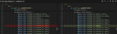

I have already commented out all llce clocks in TF-A (see attachment for TF-A modifications). Do you still need to modify u-boot or kernel? How to modify?

I found that in tf-a, I did not modify the clock source in the device tree. After modifying it, the LLCE clock is correct. Thank you for your support;
