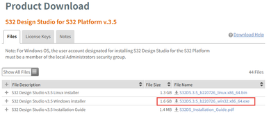

Hello NXP Support,
I downloaded the S32 Design Studio 3.5 Update 13 (D2407) package for Windows from your website. The downloaded file was a .zip archive, but after extraction I could not find the setup.exe file required to install on Windows.
Please confirm:
  1. Is the Update 13 ZIP only an update/patch and not a full installer?
  2. If so, can you provide the correct link to the full offline installer for Windows (with setup.exe) for S32DS 3.5?
  3. Any additional installation instructions for Update 13 would also be helpful.
This is required for our work on S32G3 M7 Bootloader and MCAL integration.

Hello, @Sunilap
Thanks for the post.
I suggest trying the following way for accessing the S32DS3.5
1. To access the https://www.nxp.com/design/design-center/software/automotive-software-and-tools/s32-design-studio-id...
2. Press the button shown below:
3. From the page opened, find the 3.5 installer.
4. While downloaded and installed, it is S32DS3.5.0, then update it automatically via “S32 extensions and updates”(could be 3.5.14 after updating, since it is updated to the latest verison) or use the zip file downloaded as mentioned in your post directly.(could be 3.5.13)

Resolved!!!!
