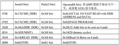

Thanks a lot for the information.  I was checking the guide you referenced and I see the suggested changes in some registers you have modified in the QSPI parameters you just sent. However, there are some registers I did not see mentioned in the guide but were modified:
I notices that this register was mentioned in a Linux related patch, for BSP30, my understanding is that it does not need to be changed for the QSPI parameters used for Boot ROM.
For the following registers, can you provide more information as why you changed them? since I cannot access the memory documentation.
Also, have you checked the QSPI lines in the board with an oscilloscope? if so, can you share the signals you see in the QSPI lines or if you don't see anything at all?

About the " For the following registers, can you provide more information as why you changed them? since I cannot access the memory documentation. " => The changes I did were based on the info from the SoM provider.
And they are the same as in the quoted ref.:
The QSPI config. are confirmed to work in a linux system.

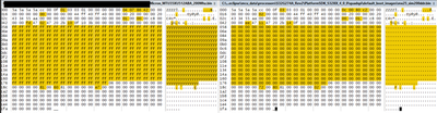

  • Comparing one of the available configurations with yours I notices that de padded part is in 0xFF in yours and it is 0x00 in one of the provided by us, on the right is your configuration and on the left is one of the available after isntalling S32DS:
    • Did you changed this deliberately?
