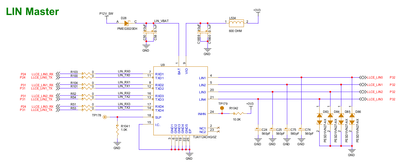

On board S32G-VNP-RDB2 with BSP 42.0.
I got the LIN UART device:
FLEX_LIN: /dev/ttyLF2
LLCE_LIN: ttyLF3 ttyLF4 ttyLF5 ttyLF6
then How can I know the LIN port is in Master or Slave mode?
In Linux user space, for example, with tools like stty or some others.
and How can I set the LIN port mode, master or slave?

but according to the S32G-VNP-RDB2 sch
S32G-VNP-RDB2_DesignFiles/Schematic/SPF-47440_E.pdf
LLCE_LIN connect LIN Bus PHY chip: TJA1124CHG/0Z.
UART + LIN_PHY?

chenyin_h
Hi, @liujialu_2024
Thanks for your post.
From BSP UM, the LINFlexD on S32G is configured to UART mode in the BSP, it is not supported as LIN mode(both master and slave) in the BSP.
As a result, there is no such examples/implementation for your requirement.
Sorry for your inconvenience.
Chenyin
