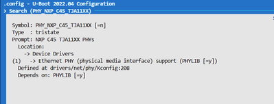

Hi All,
I am using a custom s32g2 based hardware with PFE2 is connected to serdes0.
Here are my dts setting working in kernel :
&pfe_netif2 {
status = "okay";
phy-mode = "sgmii";
phy-handle = <&pfe_mdio_b_phy2>;
managed = "in-band-status";
&pfe_mdio2 {
status = "okay";
/* TJA1104B */
pfe_mdio_b_phy2: ethernet-phy@2 {
reg = <27>;

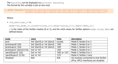

Thanks for reaching out to us. Regarding your question, the SerDes configuration in U-Boot, and therefore the SGMII configuration is managed by an environment variable, the hwconfig variable, for more information please check your BSP user manual, for example for BSP44 check section 7.2.2 SerDes configuration for SGMII in U-Boot in particular page 51:
If you have already check this information, please share the following so I may be able to offer you better support:
  • BSP version
  • hwconfig current value
Thanks in advance

The BSP version is 43 and the hwconfig used is:
hwconfig=serdes0:mode=xpcs0&xpcs1,clock=int,fmhz=125;xpcs0_1:speed=1G;serdes1:mode=xpcs0&xpcs1,clock=int,fmhz=125;xpcs1_1:speed=1G

Thanks for the information. Just to be completely clear, were you able to test with the default DT? My concern at the moment is that the DT fixups and your DT changes are in someway incompatible. This is because u-boot modifies the Linux DT according to the hwconfig value, and it does the same with the ATF DT (this configuration is volatile). So, I have two recommendations for now:
  • Test with default ATF DT and your current value of hwconfig
  • Test with your modified ATF DT and skip SerDes0 configuration in u-boot, for your setup it would be:
  • serdes0:mode=xpcs0&xpcs1,clock=int,skip=boot,fmhz=125;xpcs0_1:speed=1G;serdes1:mode=xpcs0&xpcs1,clock=int,fmhz=125;xpcs1_1:speed=1G
notice the skip=boot. You can also use skip=kernel, to prevent u-boot from modifying the Kernel DT.
Please let me know if the behavior changes.

I was expecting the hwconfig to do the clk setting in u-boot
because in kernel i see the clock details as:

You can also try configuring the CONFIG_PHY_NXP_C45_TJA11XX to your configuration with the menuconfig in u-boot:
Which adds support for the TJA11 family.
Since I do not have your board I cannot test the exact effects of the changes, however, please test each alone and then both.
If the problem persists, please also share the output of the dm tree command in u-boot, to compare it with my own.

CONFIG_PHY_NXP_C45_TJA11XX=y
CONFIG_PHY_TI_DP83867=y
CONFIG_PHY_TI_DP83869=y
CONFIG_PHY_TI=y
CONFIG_PHY_TI_GENERIC=y
#CONFIG_LOG=y
#CONFIG_LOG_MAX_LEVEL=8
#CONFIG_LOG_DEFAULT_LEVEL=8
#CONFIG_LOG_CONSOLE=y
Why MDIO list is still detecting it as Generic PHY ?
