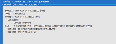

You can also try configuring the CONFIG_PHY_NXP_C45_TJA11XX to your configuration with the menuconfig in u-boot:
Which adds support for the TJA11 family.

my u-boot defconfig is as:
CONFIG_ARM=y
CONFIG_ARCH_S32G2=y
CONFIG_TARGET_S32G274ARDB2=y
#CONFIG_TARGET_S32G2XXAEVB=y
CONFIG_QSPI_BOOT=y
CONFIG_SPI_FLASH_STMICRO=y
CONFIG_ENV_SPI_BUS=6
CONFIG_ENV_SPI_CS=0
CONFIG_USE_DEFAULT_ENV_FILE=y
CONFIG_DEFAULT_ENV_FILE="uEnv.txt"
CONFIG_S32CC_QSPI_FREQ=133
CONFIG_SPI_FLASH_MX25UW51245G=n
#CONFIG_ENV_OFFSET_REDUND=n
CONFIG_NXP_PFENG_FW_PART="0x32c0000"
CONFIG_ENV_SIZE=0x10000
CONFIG_ENV_SECT_SIZE=0x20000
#CONFIG_S32CC_HWCONFIG="serdes0:mode=xpcs0&xpcs1,clock=int,fmhz=125;xpcs0_1:speed=1G;serdes1:mode=xpcs0&xpcs1,clock=int,fmhz=125;xpcs1_1:speed=1G"
CONFIG_EFI_PARTITION=y
CONFIG_PHY_NXP_C45_TJA11XX=y
CONFIG_PHY_TI_DP83867=y
CONFIG_PHY_TI_DP83869=y
CONFIG_PHY_TI=y
CONFIG_PHY_TI_GENERIC=y
#CONFIG_LOG=y
#CONFIG_LOG_MAX_LEVEL=8
#CONFIG_LOG_DEFAULT_LEVEL=8
#CONFIG_LOG_CONSOLE=y
Why MDIO list is still detecting it as Generic PHY ?
