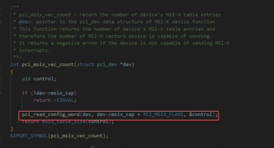

Hi NXP team,
    The platform I'm using is S32G274A-RDB2 and the SDK version is BSP38.0.
    I am currently using a Realtek 9071CP switch chip, which is a device with a PCIe interface. I connect to it using PCIE1.
    The current problem is that it can be recognized by pcie,  but loading its driver will cause the kernel crash.
    The process of crash is:
                       pci_enable_msix_range
                       |->__pci_enable_msix_range
                                |->pci_msix_vec_count
                                    |->pci_read_config_word
    The detailed crash log is as attached 'crash.txt'.
    By the way, the configuration of PCIE in U-Boot is as follows: hwconfig=pcie0:mode=pcie,clock=ext;pcie1:mode=pcie,clock=ext

Do you check whether the Realtek 9071CP supports the MSI-X? In addition, could you share the crash.txt file, I can not find the file.

Hi Joey_z,
    I have re-uploaded the log of crash.
    Realtek 9071CP supports msi-x. I have verified this driver on other platforms.

According to your information, the rtase.ko module did encounter problems during the loading process. The error occurred when the driver attempted to initialize. Please check whether there is a conflict in the memory used for driver initialization.
