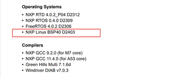

1-2. The BSP does not include the IPCF module. You can refer to this link: https://github.com/nxp-auto-linux/ipc-shm.git to download this module. You can also refer to AN13750 to learn more about how to use the module.
3.The latest version of IPCF is 4.10.0, which supports BSP40 as mentioned in the release notes. BSP42 is a newer version, so you can try it, but the recommended version is BSP40.
