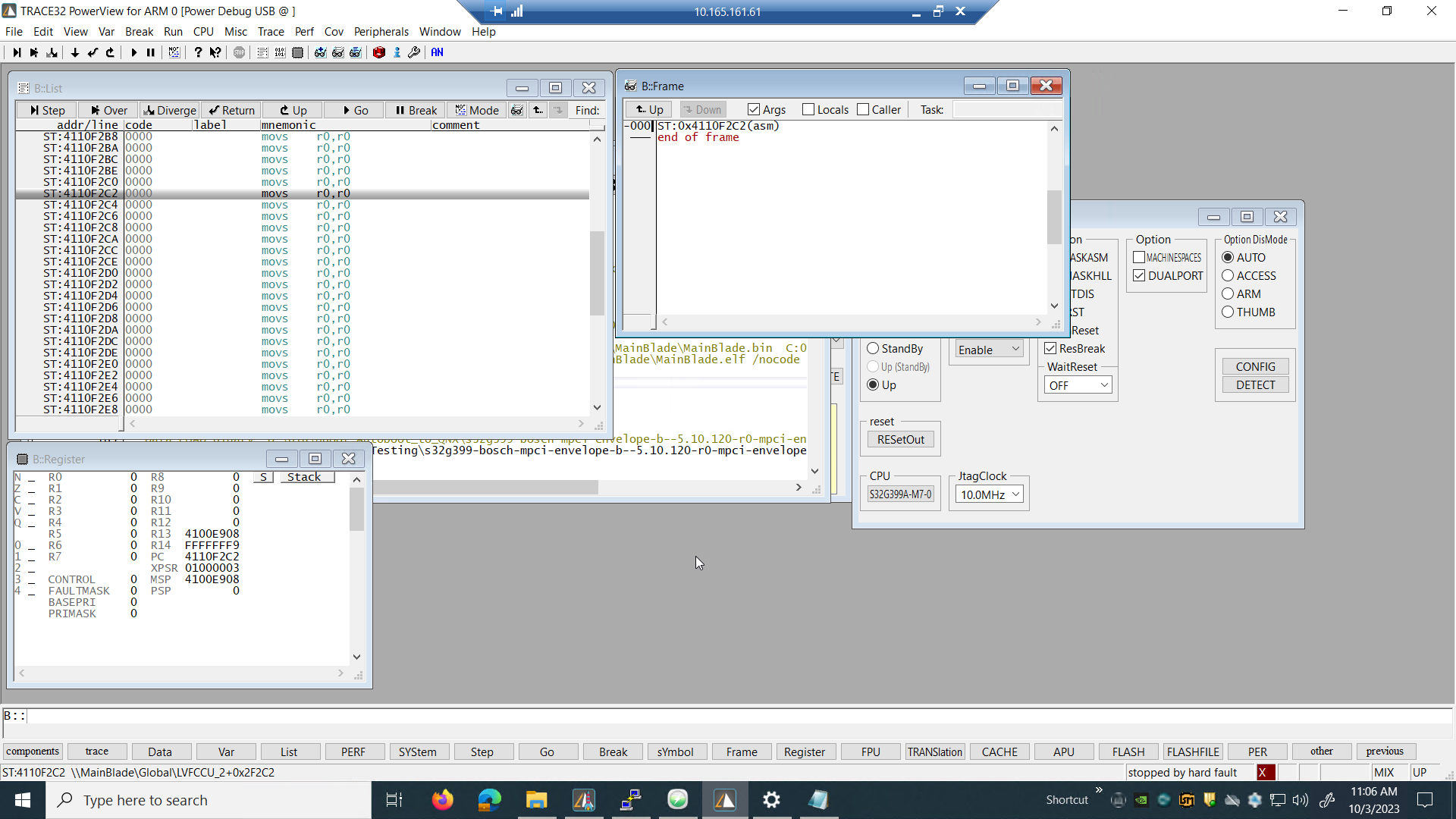

I am working on an attempt to run an application on M7 in the S32G399A board, using Uboot.
I was able to load the binary into the SRAM from NOR memory. But after starting M7 from the SRAM address, The PC is jumping to an address in the QSPI RX buffer region, and the program is running with lockedup warning.
Also, the debugger is showing the message, LVFCCU_2 = 0x410E0000; + 2F2C2 =   4110 F2C2
What could be reason for this, how to debug the same?

Hi @Daniel-Aguirre ,
Iam using NXPS32G399A board and BSP32.
I've tried flashing the IPCF example using Uboot and it is running fine. But using same Uboot , iam not able to run an M7 application running classic AUTOSAR.
Ive attached snapshot of the debugger window.
Thankyou.
In Uboot commandline, iam using the following commands.
sf probe 6:0
sf read 0x80000000 0x00AC0000 0x900000
dcache off
mw.q 0x34000000 0x0 0x900000
cp.b 0x80000000 0x34000000 0x900000
startm7 0x34100204
and in the console, it is showing the message "starting cm7_0 core at SRAM address 0x34100204"
But ,upon attaching M7 from the debugger, application is running with lockedup warning. Also PC is jumping to some other address (0x4110F2C2) , which is not from the SRAM region.
