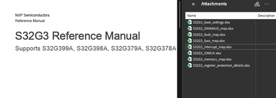

alejandro_e
Hello @Jeff-CF-Huang,
 I have checked the related information of your problem, I was not able to find much information related to your problem. Can you share the lines in which the M7 is disabling the interrupt so I may look further into it?
The only relevant document I was able to find is in the S32G3_interrupt_map.xlsx attached with the reference manual:
You can see the following, it is an OR of all pin interrupts:
Can you give me more context about how and why are you disabling this interrupt in the M7?
