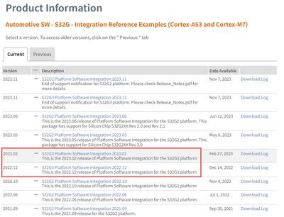

I'm working on booting a53 and m7 cores of s32g3 soc parallely. Im following  the AN13750 document. In the document the below file is mentioned
Platform_Software_Integration_S32G2_2022_06.exe
Where can i find this file for s32g3 soc.

Hello, @Niranj_369
Thanks for the post.
1. For S32G3, there are two versions existed, you may find it from your NXP account
2. But currently, the "Integration Reference Examples" is end of support, if you are willing to try the M7 bootloader, newer version projects are provided within the GoldVIP package, you may reference the GoldVIP for details.
Chenyin

chenyin_h
Hello, @Niranj_369
Thanks for your reply,
It is the flexnet link, commonly it is only available for your when you had logged to the NXP.com.
If you are searching for the certain package within your account, you may find the package from the list, or try searching it the following way when logged in with your NXP account.
Chenyin

Niranj_369
Hi @chenyin_h
I tried to access the page using the below link  but it redirects to the nxp profile page. Yesterday it was working for sometime.
https://nxp.flexnetoperations.com/control/frse/product?child_plneID=854617&cert_num=206694071
