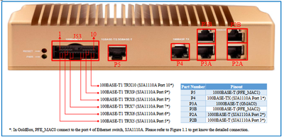

  4. Connect PFE2 ethernet port of the S32G2 board to your local network. In the case of the RDB2/GoldBox, this is port P3B.
