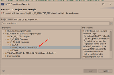

I want to implement the use of LLCE_LIN, I downloaded the LLCE firmware version 1.07, using the sample:
But I can't run, compile an error.
The original peripheral configurations are as follows:
The compilation error is as follows:
Error after adding missing set of header files:
What are the requirements and configurations for this project?

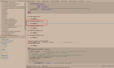

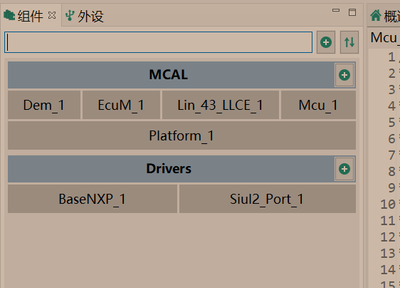

I added RM to the component,
Then I can go through the compile, but when debug appears in this place to hang up:
Do I need to add this RM component? If so, is this component not configured properly? How it should be configured; If not, how to solve the above error?

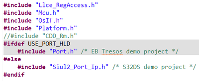

2. Modify the variable under the Mcu_Init function:

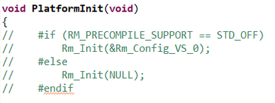

3. Comment all XRDC/Rm includes/functions:
4. As per the "description.txt" file under the example, add the required modules and delete the specific source file.
