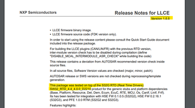

Although it may not be the source of the problem, I recommend upgrading the LLCE version 1.0.5, which is the one tested with the RTD 4.0.0, as you can see in its release notes [Release Notes for LLCE, Version 1.0.5, 16 December 2022]:

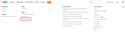

If possible, please share your project so I may have a better understanding of it, if you prefer you can open a support ticket so you can upload your files privately:
