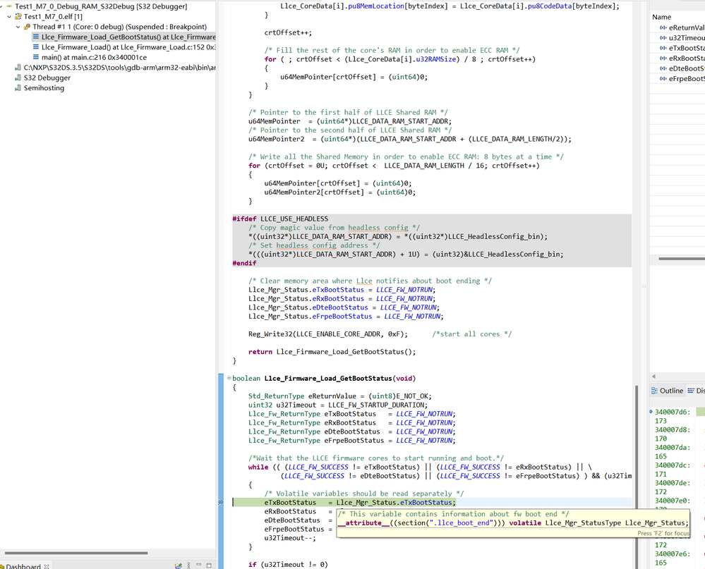

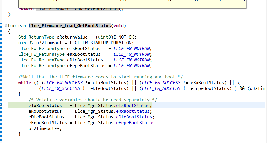

    When I am porting the LLCE CAN example, it will jump to HardFault_Handler when running "Llce_Firmware_Load_GetBootStatus", but the official nxp example is fine, please help me to analyse what may be the reasons for the failure of LLCE firmware initialisation.Snipaste_2024-07-24_21-21-47.pngSnipaste_2024-07-24_21-21-47.pngSnipaste_2024-07-24_21-21-59.pngSnipaste_2024-07-24_21-21-59.png

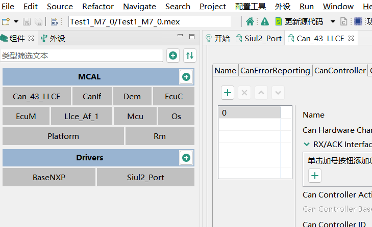

The environment used is S32DS 3.5 & S32G-VNP-RDB3 development board & SW32G_RTD_4.4_4.0.2 & S32G_LLCE_1_0_8.
The following are my porting steps.

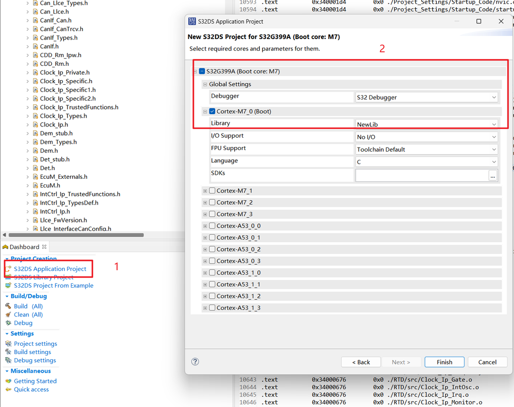

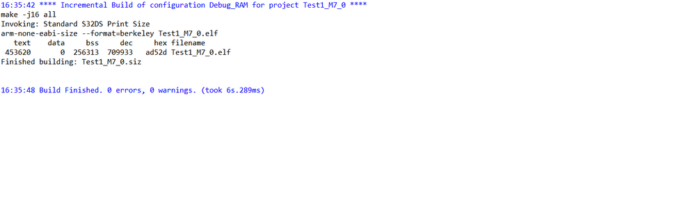

1. Add new "S32DS Application Project"
2. Adding components against the configuration of "Can_Llce_DS_Can2Can_S32G399A_M7",and generate code

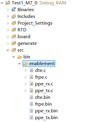

3. Adding LLCE bin file and C code to the projectSnipaste_2024-07-25_16-34-24.pngSnipaste_2024-07-25_16-34-24.png
4. settle error

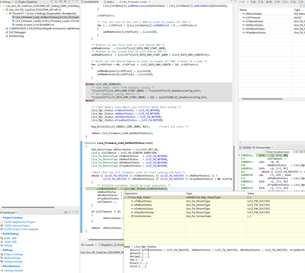

Another,during debugging, I found that by placing the mouse over "Llce_Mgr_Status", its value can't be seen, but it can be seen in the official routine, as shown in the following two pictures, the first one is the official routine and the second one is my own routine
So,please also tell me why the "Llce_Mgr_Status" variable cannot be loaded.(ps: my link file is a direct port of the official routine.)
Snipaste_2024-07-25_16-42-19.pngSnipaste_2024-07-25_16-42-19.pngSnipaste_2024-07-25_16-40-09.pngSnipaste_2024-07-25_16-40-09.png

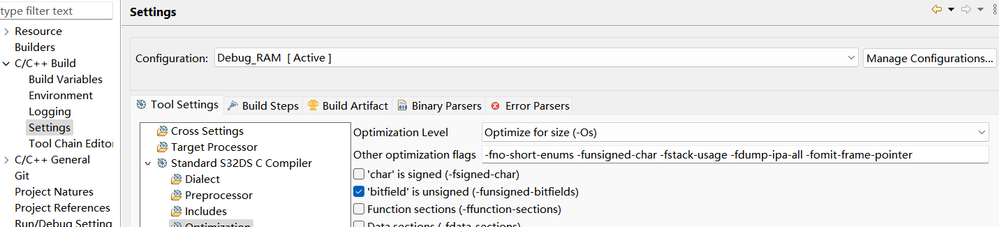

Can you confirm in which optimization is your project at?
You should be able to find it under Properties > C/C++ Build > Settings > Standard S32DS C Compiler >  Optimization
Please, let us know.
3,045件の閲覧回数
jiajun
 Properties > C/C++ Build > Settings > Standard S32DS C Compiler >  Optimization > Optimize for size (-OS)Snipaste_2024-07-26_10-23-02.pngSnipaste_2024-07-26_10-23-02.png
