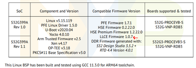

Daniel-Aguirre
We understand that you are using LLCE-FW v1.0.8 with BSP38.0. If so, we see under the BSP38.0 release notes that the compatible LLCE-FW version is v1.0.7 [Page 2, Linux BSP 38.0 Release Notes for S32G3, 10/2023]:
We can recommend using LLCE-FW v1.0.7 to confirm the problem is not related to compatibility.
Please, let us know.

Daniel-Aguirre
