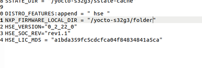

ashwini2024
The below is my configurations in local.conf as per bsp 40 user manual:
