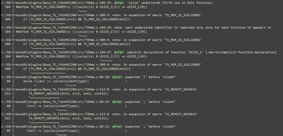

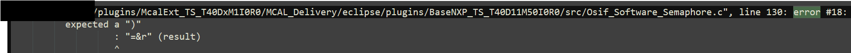

As you suggested, I tried building the project using the GCC compiler instead of GHS. This resolved the semaphore-related error. However, I’m still encountering a usize-related error during the build process.
I’ve attached a screenshot of the error for your reference.
Could you please advise on how to resolve this issue?

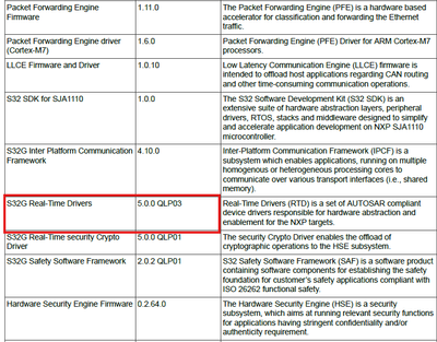

I confirm that I used the RTD version specified in the manual.

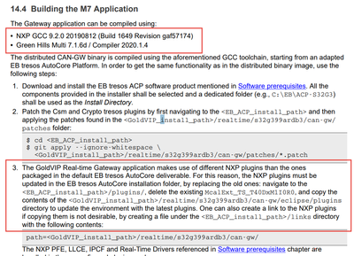

For your reference, I’ve attached the page from the user manual that lists the required version.
Thanks again for your assistance.

I only installed EB tresos version 27.1.0 and ACP 8.8.7 for S32G27x, and the package was included by default.
Please let me know if a different version is required.

Your ACP 8.8.7 is normal. You can refer to the User-Manual.pdf to check the complier version and plugins.
