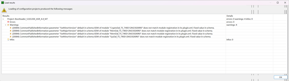

Hi, I already copied the specified software packages according warning message, but still keep there, what is the reason ? and how to fix them ?

The warnings are referring to the SW versions you are using. Are you using the RTD version required for the Bootloader? Have you copied the needed plugins from the Bootloader project to the Tresos plugin folder?
If so, then you should be able to advance ignoring the warnings. Can you build the application?
Please, let us know.

Project: Bootloader_S32G3XX_ASR_4.4_M7<br>CommonPublishedInformation parameter "SwMinorVersion" default in schema XDM of module "CryptoDal_TS_T40D12M2302I0R0" does not match module registration in its plugin.xml. Fixed value in schema.

【1】
Project: Bootloader_S32G3XX_ASR_4.4_M7<br>CommonPublishedInformation parameter "SwMajorVersion" default in schema XDM of module "MemDal_TS_T40D12M2302I0R0" does not match module registration in its plugin.xml. Fixed value in schema.
【2】
Project: Bootloader_S32G3XX_ASR_4.4_M7<br>CommonPublishedInformation parameter "SwMinorVersion" default in schema XDM of module "MemDal_TS_T40D12M2302I0R0" does not match module registration in its plugin.xml. Fixed value in schema.
【3】
Project: Bootloader_S32G3XX_ASR_4.4_M7<br>CommonPublishedInformation parameter "SwMinorVersion" default in schema XDM of module "SysDal_TS_T40D12M2302I0R0" does not match module registration in its plugin.xml. Fixed value in schema.
【4】
