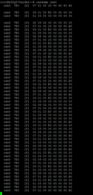

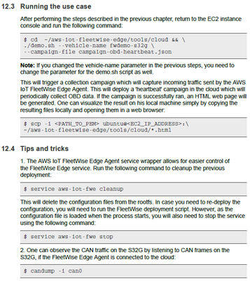

I´m having problems with the demo aplication of the GoldVIP image, I followed the steps in the S32G Vehicle Integration Platform (GoldVIP) User Manual chapter 12.2 and 12.3.

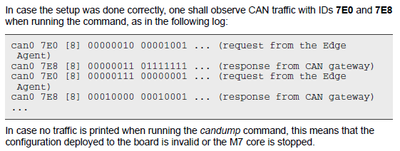

When I run the candumo can0 command I can see that the edge agent is requesting data as shon in the image bellow:
but there is not answer from part of the core M7 application, in the user manual says that it could be because the core M7 stopped but how do I run it again?
also in one of the firs tests I made the core M7 answer correctly but then stopped responding

5,768件の閲覧回数
eliozepeda
Hello @MayanksPatel I´m running the goldvip-gateway application, in that application is configurated some gateways and also is configured the DCM and DEM that are running on M7 to answer to the Edge agent requests of services like 01, 03, 09 as described in chapter 12.0, but this application is not answering to the requests, it seems it is stopped

Hi @eliozepeda,
In this case, the M7 core stopped due to an issue. you can perform the steps from flashing goldvip-gateway.bin. It will again restart the M7 core.

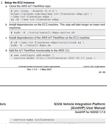

Then I followed the steps documented in the user manual to install the Fleetwise edge agent to the goldbox:
As I mentioned the edge agent is doing the request correctly with the CAN ID 7E0, but the M7 is not responding nothing, it should response something like the image above.
