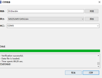

I use S32G_LLCE_1_0_4\sample_app_llce\llce_sample_app_pfe, Generate elf files according to AN13423.pdf(Using CAN2CAN, CAN2ETH and ETH2CAN Features of LLCE on S32G), and debug using trace32 can run normally. However, I used gcc objcopy to convert elf files to bin files, and burning bin files into Norflash did not start properly because the Ethernet port did not receive acf-can messages. In addition, I tried to use the same method to burn LED firmware into Norflash, the system can run normally. Do I need to modify the linked file for the LLCE routine to start properly in Norflash? Below is my operation step:
1. Use objcopy to generate a bin from elf
2.Use the S32DS to add IVT,Open S32G_LLCE_1_0_4\sample_app_llce\llce_sample_app_pfe\build_files\autosar_intram.gld to view the start address, open the map file to view the entry address, fill in.
3.After the IVT firmware is exported and burned, the startup mode is set to norflash, and the IVT fails to run properly.

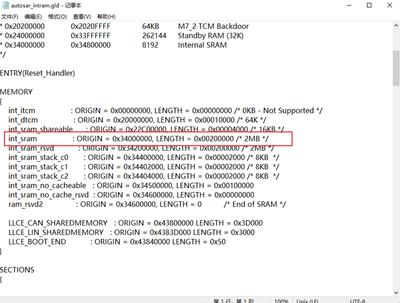

There seems to be a bug under the linker files for the pfe project under LLCE v1.0.4:
"I found the corresponding defect in the linker file of the llce_sample_app_pfe. The address of LLCE_BOOT_END is wrong in the autosar_intram.gld.
Wrong : LLCE_BOOT_END : ORIGIN = 0x43840000 LENGTH = 0x50
Correct :  LLCE_BOOT_END : ORIGIN = 0x4383C8A0 LENGTH = 0x50
Due to this defect, Llce_Firmware_Load() refers the wrong address, which will never be updated by the LLCE FW."

no,I chang linkfile to LLCE_BOOT_END : ORIGIN = 0x4383C8A0 LENGTH = 0x50,it also have same situation.
