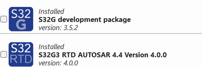

After installing RTD and development package for S32G399A in S32DS, the example project for M core can be loaded.

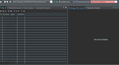

I am trying to create a project for DDR configuration for TF-A. Would it work if the example project for M core is used as a start? But it seems the code is not generated for DDR init and pin tools is disabled as below:
If not, where to find an example project to do that?

chenyin_h
Hello, @cranes
Thanks for your post
May I know which version RTD and S32DS are used in your test? I have tried it on my S32DS3.5.14 and it seems no issues
Chenyin

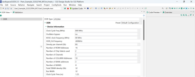

cranes
Thank you for your reply.
Here is the S32DS version:
Here is the RTD version:
By the way, the pin tool works fine for the example project for S32K series MCUs.
Thanks!
Crane
1,113 次查看
chenyin_h
Hello, @cranes
From the release notes of RTD4.0.0, it is developed and tested on S32DS3.5.1, and may not be fully tested on 3.5.14, from my working experience, if possible, I suggest using the RTD4.0.2 serials for another trial.
As mentioned, I have tested it on S32DS3.5.14 with RTD4.0.2 HF03, there is not issue found.

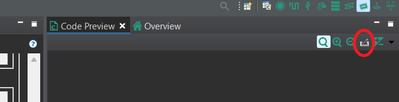

cranes
Thanks and it works now.
But the code is not generated. Nothing in "Code Preview" tab and the "export" icon is in gray.
What might still be missing?
Thanks!
Crane
1,068 次查看

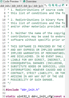

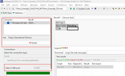

chenyin_h
Hello, @cranes
Thanks for the reply.
It could not be directly generated.
1. Try validating the DDR the following way
2. Then update the code, the ddr related could could be seen from the code preview tab
I hope it will help
Chenyin
1,008 次查看
cranes
Ok, got it. Does it mean the code can only generated after the configuration is validated? Even with any minor change, the validation is still required to generate the code?
Thanks!
Crane
964 次查看
chenyin_h
Hello, @cranes
Thanks for your reply.
Yes, it is suggested.
Chenyin
