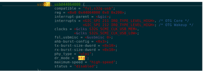

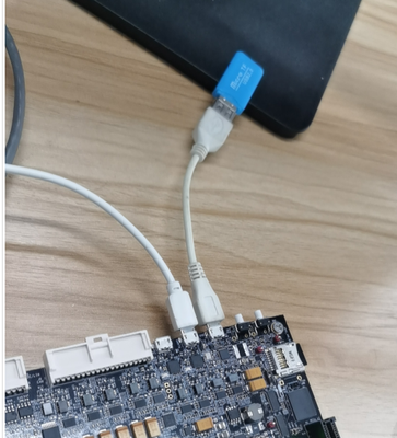

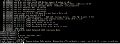

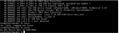

We want to use the OTG function in S32G,
Firstly, we use the default dts configuration(host mode only), it seems that the  device was detected successfully.
QA1:OTG-Host Mode
But we  tried to change it to OTG mode, the OTG cable(BUS) was detecded and the device was not
QA2: OTG-Device Mode

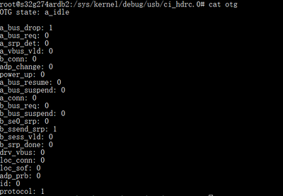

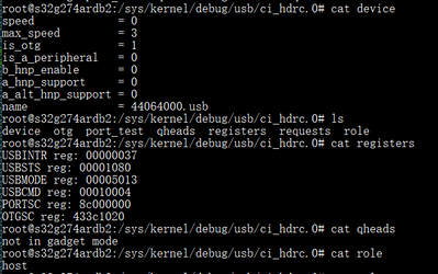

When we use the normal microUSB -> TypeA cable(not OTG Cable) and connect to computer,
from debug sysfs, it seems that the mod was changed to gedget mode,
but nothing message output to dmesg and the computer(windows 11) no any response.
So could you tell us if we make mistake somewhere and how to fix it?

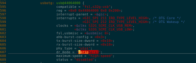

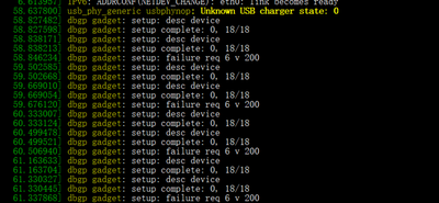

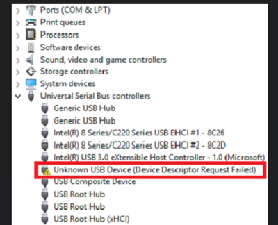

StanleyShen
When I changed the dr_mode to peripheral as blow:
replace the s32g274a-rdb2.dtb and restart the S32G-VNP-RDB2, after plug USB-A to Micro-B cable and connect it to PC,
flowing message ware output to dmesg
and in the PC side, unkown device was  detected

StanleyShen
For OTG Host mode, I did some research on the driver code.
when OTG cable was plugged, the
hub_irq->hub_event would be executed and a new hub was detected as a new device,
but after it, when the USB device was plugged, the hub_irq not called.

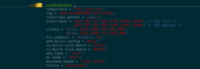

MayanksPatel
Hi @StanleyShen,
Hope you are doing well.
I have seen the device-tree image attached by you and found that in USB dr_mode=host needs to be defined for OTG Support as the board would be the host for the pen drive you are going to access.
Change it in the device-tree and check if it is detecting or not.
Mayank s Patel
4,974 次查看
StanleyShen
Hi Mayank
As you see in my thread, I have already changed dr_ The mode  to OTG, but it still does not work properly.
both Host role and device role are failed(Pls refer to the description of QA1 and QA2)
