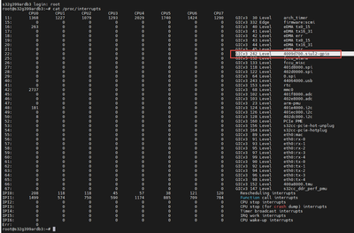

We want to turn off GIC-500 242 on Linux kernel to avoid competing with M-core for EIRQ.
Could you guide us on how to achieve this, such as through DTS or other configurations?

Check the interrupts information, The 242 interrupt is used to gpio.
You can try to modify the file of (ATF/fdts/s32g.dtsi), it has the define for gpio in this file.

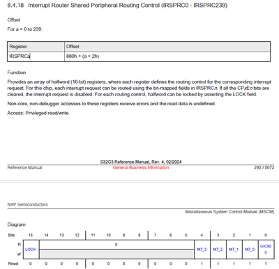

Could you guide us on how to keep this IRQ on the A53 cores without routing it to the M7 cores?

hi,Jeff-CF-Huang
Thank you for your reply.
If you do not check the interrupt of SIUL1_ORED_IRQn, you are not enable the interrupt in M core.
Hope it can help you.
