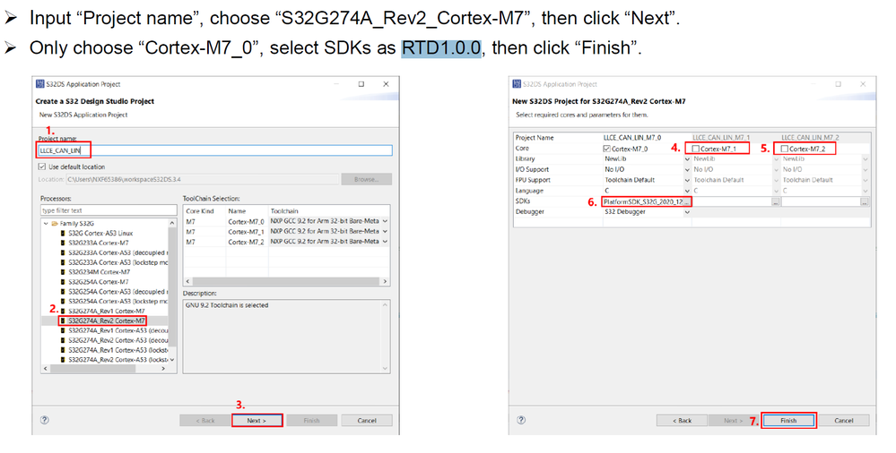

So I refer following tutorial to make application.
https://www.nxp.com/document/guide/getting-started-with-the-s32g-reference-design-board-2-for-vehicl...

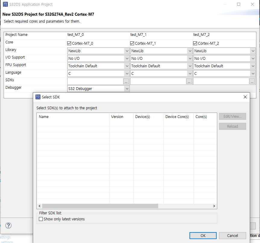

In my case, I can not add "SDK RTD1.0.0".
Could you please help let me know how to add SDK RTD 1.0.0 for S32G??

Which S32 Design Studio version are you using? At this moment, the publicly available RTD's are only supported on S32DS v3.4.
Also, we may recommend looking into the "S32G-VNP-GLDBOX Software Enablement Guide" where more information is provided on this manner. This guide is provided on the S32G-VNP-GLDBOX product page (link: GoldBox for Vehicle Networking Development Platform | NXP Semiconductors).
We also recommend looking into the S32DS community for these topics. Below will be a post that also talks about this inquiry:
S32DS Extensions & Updates: Explanation and How To... - NXP Community
Also, we may recommend looking into newer version of the RTD (v3.0.2, v3.0.3) given they could be more stable than the version you are trying to use.
Please, let us know.

As like your comment, I will use S32DS v3.4 for using RTD.
