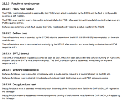

At the reference manual of the S32G2 you could find the following:
[page 1144, S32G2 Reference Manual, Rev. 8, February 2024]

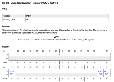

The software functional reset can be trigger at the following register:
[page 1311, S32G2 Reference Manual, Rev. 8, February 2024]

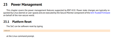

From the Linux BSP side I found the following at the BSP 42 User Manual:

The reboot command mentioned in the user manual triggers a destructive reset, not a functional reset.

Another way to run a functional reset is to request it to the registers I share before. At your M7 core using the RTDs you can request the functional reset with the fuctions at Power_IP or Mcu.
Some functions you can review to run the fuctional reset can be:
Power_Ip_PerformReset (definition at Power_Ip.c)
Power_Ip_MC_RGM_PerformReset (definition at Power_Ip_MC_RGM.c)
Mcu_Ipw_PerformReset (definition at Mcu_Ipw.c)
Mcu_PerformReset (definition at Mcu.c)
Those function are from RTD 4.4 4.0.2 the names can vary in the different versions.
