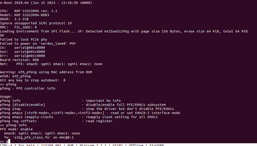

Platform Description
soc:S32G399
bsp: bsp35
pfe:s32g_pfe_class.fw  (1.5.0 md5sum 0b46ffc4ee207e4334608e312dc16551)
uboot configuration:
=>setenv hwconfig "serdes0:mode=pcie,clock=ext;pcie0:mode=rc;serdes1:mode=xpcs0&xpcs1,clock=int;xpcs1_0:speed=1G;xpcs1_1:speed=1G"
=>setenv pfeng_mode "enable,sgmii,sgmii,none"
=>setenv ethact eth_pfeng
=>setenv pfengemac 0
=>setenv gatewayip "192.168.1.1"
=>setenv ipaddr "192.168.1.30"
=>ping 192.168.1.101
When I use pfe0 to test ping, it's  failed
1. please tell me how to debug.
2. Am I using the correct version of PFE?

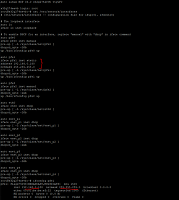

Q3:How to configure static IP?
          I have added     'init ifupdown'   to  fsl_image_auto.bb“,     but it seems that it has not taken effect. I must manually execute ifconfig pfe0 up
6,142件の閲覧回数
Daniel-Aguirre
We have added the following information under "/etc/network/interfaces" and on reboot we see the static IP being applied, image below:
Please, let us know.
6,120件の閲覧回数
Coco111
Thanks for your help. I have modified the interface file, but it doesn't take effect.

For BSP35.0, PFE FW 1.5.0 seems to be correct.
Which mode are you trying to configure for SerDes_1?? We understand you are trying to implement Mode 3, but we would like confirmation.
If so, we see that there is a difference between the recommended command and the one you are using. Below will be one option of the available configurations:
=> setenv hwconfig "serdes0:mode=pcie,clock=ext;pcie0:mode=rc;serdes1:mode=xpcs0&xpcs1,clock=ext,fmhz=125;xpcs1_0:speed=1G;xpcs1_1:speed=1G"
The clock is set to "ext", as it is defined for RDB3 platform. Also, we seem to understand that you are working with a custom board, is that correct?
Also, there is an Ethernet Enablement Guide for RDB3, which could provide useful. It is available under the RDB3 product page (link: S32G3 Vehicle Networking Reference Design | NXP Semiconductors)

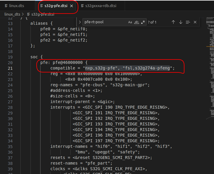

2. I did not find any drivers corresponding to 'nxp, s32g pfe, fsl, s32g274a pfeng' in the Linux code, Please tell me why??

Q2 >> I did not find any drivers corresponding to 'nxp, s32g pfe, fsl, s32g274a pfeng' in the Linux code, Please tell me why??
A2 >> PFE is provided under a different section. You can look into the following link for PFE drivers:
GitHub - nxp-auto-linux/pfeng: PFE Ethernet accelerator
