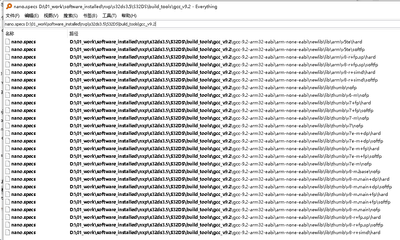

but fail on compile the 32DS project, error on
    fatal error: cannot read spec file 'nano.specs': No such file or directory
yet, I can find the nano.specs file in compiler dir

I check the installation detail and find the compiler version is not 1701,  is this the root cause? How can I get the rigth version?
do I miss other detail? please help. Thanks
