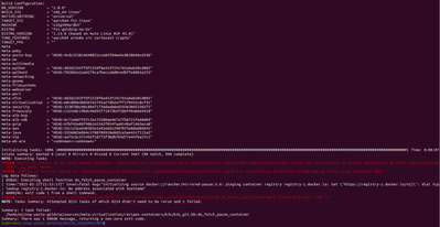

I follow User guide do the GoldVIP Yocto build. But get the follow issue.

Hi @Wzlinux,
Which version of GOLDVIP are you trying to build?
Please make sure you run all the prerequisites before building.
Did you modify some configuration for this build?

Hi @carlos_o
Thanks. the version is V1.13.
the follow is my configuration for this build. no other change. I have not install the docker (Chapter 6 in the user guide doc)in my PC . will this impact my yocto build?

carlos_o
Hi @Wzlinux,
The Docker image is required in some GoldVIP use cases. So please, follow the Chapter 6 of the User Manual and let me know what you get.
