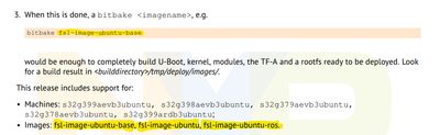

Below will be some comments on regards of your questions:
Q1) What is the difference between image-ubuntu-base, image-ubuntu, and image-ubuntu-ros.
A1 >> The following is told under the GitHub page (link: GitHub - nxp-auto-linux/auto_yocto_bsp at release/bsp38.0)
fsl-image-ubuntu-base: A system image with a minimalist Ubuntu 20.04 LTS root filesystem
fsl-image-ubuntu: A complete, development-suitable system image based on Ubuntu 20.04 LTS
which contains (among others): the complete kernel source code (for rebuilding the kernel directly on the target machine),
compilers and toolchains (for C, C++, Java), ROS Kinetic and Docker
NOTE: Please build fsl-image-ubuntu-base or fsl-image-ubuntu only for machines with name ending in `ubuntu`.
For the other machines, please use any of the images with Yocto rootfilesystem.
As for the ROS variant, we see no information from our side, we do apologize.

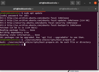

I got the access for BSP 38.0 from my local NXP representative. I am following chapter 3.1.3 BSP Ubuntu Build Page12 of the reference manual. I am using Ubuntu 20.04.6 LTS.
Running the command ./sources/meta-alb/scripts/host-prepare.sh
gives me error
Can you please advise the steps to build ubuntu image ? Thanks
-Ankit
10,042件の閲覧回数
Daniel-Aguirre
It seems that the related repo was not initialized under your current environment prior to executing the command.
The first steps should be the ones provided under Chapter 3.1.1 Building default Yocto of the BSP38.0 User Manual, then you should be able to proceed with Chapter 3.1.3 BSP Ubuntu Build instructions.
Still, let us know if you have any problems with the provided instructions.
Please, let us know.

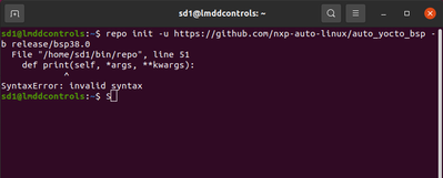

10,037件の閲覧回数
ankitv
@Daniel-Aguirre
I am getting the following error when running the command "repo init -u https://github.com/nxp-auto-linux/auto_yocto_bsp -b release/bsp38.0"
can you please advise? Thanks.
kind regards,
-Ankit
10,031件の閲覧回数
Daniel-Aguirre
This seems to be a syntax error due to the python version. Which python version do you have available?

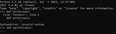

10,028件の閲覧回数
ankitv
Hi @Daniel-Aguirre ,
I am using Python 2.7.18. I also have Python 3.8.10 installed. Please let me know which version should I run it with. Thanks
-Ankit
10,021件の閲覧回数
Daniel-Aguirre
Thanks for your update. Is your default python version 2.7 or 3.8?
This seems to be a problem with python 2.7. We see the following from our side:
Once we move to python 3.8, we can proceed no problem:
10,017件の閲覧回数
ankitv
Hi @Daniel-Aguirre
Thanks for the quick reply, I got it working by following this workaround(2)
https://community.nxp.com/t5/i-MX-Processors-Knowledge-Base/repo-issue-quot-def-print-self-args-kwar...
I completed 3.1.1 and moved to 3.1.3

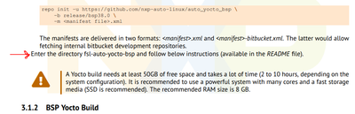

10,001件の閲覧回数
Daniel-Aguirre
Where are you executing the command? Still under the same directory as before?
The following instruction is provided at the end of Chapter 3.1.1:
For which, the commands shown under Chapter 3.1.3 should be executed inside the fsl-auto-yocto-bsp folder.
9,969件の閲覧回数
ankitv
Hi @Daniel-Aguirre
I got it working. I was able to build and test it on the Goldbox. Thanks.

Daniel-Aguirre
