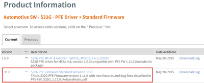

chenyin_h
Thanks for the reply, @hulk101
From the log, the PFE FW is not found by the Yocto, have you added it according to the UM?
Chenyin
2,342 次查看
hulk101
Hi, @chenyin_h
NXP_FIRMWARE_LOCAL_DIR is not added. I have searched for the "s32g_pfe_class.fw" file and was not able to find it. Should I create this file by my own ?
2,340 次查看
chenyin_h
Hello, @hulk101
Thanks for your reply.
No, the file mentioned is the PFE FW which is provisioned by NXP, you may download it in your account, like this:
Note that this is not the version used for BSP38, you may try downloading the 1.7.1 PFE FW for using with the BSP38.
I hope it will help.
Chenyin
