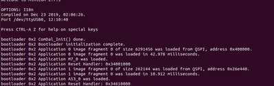

Step2: In NxP boot I have configured ATF booting and I have generated IVT by enabling eFuse and configuring HSE(HSE backup image) and flashed on to the target. Here A53 core booting is not happening and its stuck in booting and showing that A53 core loaded and reset handler address is 0x34610000

While creating blob we have placed hse at 0x1200 and hse sys image at 0x6400 then updated load address as 0x346062c0 as in  the log do compile image layout and even the reset handler address is updated to 0x34610000 Source address in QSPI as 0x601240 and load address in RAM as 0x34606b00.
I have copied the kernel image , rootfs and dtb file to the SD card.
I have flashed the IVT blob, the fip.s32-sdcard.
I am getting the below error the control is not going to the atf and it is stuck at the reset handler.
What is the fault and Are there any modifications or should i add any support on the yocto side ?
Please do reply.
Thank you.

ashwini2024
The following is my local.conf file :

Inside my /folder/hse/bin the fw file is as follows:
rev1.0_s32g3xx_hse_fw_0.20.0_2.22.0_pb230821.bin.pink
 Now when i do bitbake ros-image-core and generate the .sdcard file and copy it and flash on the target machine and do sd card boot ,
i am not getting any logs and the output is as below displayed in the image.
Please let me know where i am doing an error .
THank you.
3,802 次查看
Celeste_Liu
In your environment, when executing the command "ls /yocto-s32g3/folder", the returned result is "HSE_FW_S32G2XX_0_2_22_0". Inside the path "/yocto-s32g3/folder/hse/bin", the firmware file is as follows: rev1.1_s32g3xx_hse_fw_0.20.0_2.22.0_pb230810.bin.pink.
For this purpose, please add a line "HSE_SOC_REV = "rev1.1"" in the local.conf file.
