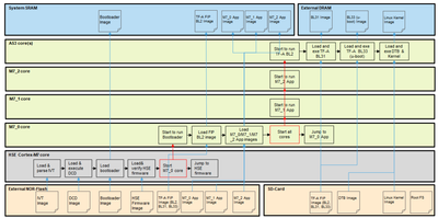

Hi @xlfd_1981,
For Multicore applications you need to implement a Bootloader
You could find an application note about this topic as Enabling Multicore Application on S32G2 using S32G2 Platform Software Integration, you could review it to learn how to create and configure the bootloader for your application.
Also, there is a figure that shows how is the boot flow working on the device (the application note and the figure includes the implementation of the BSP, but you could only use the M7 cores if you want)
